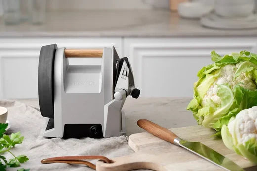

Everyone knows that a knife should be sharp, but a surprising number of people still have dull knives in their kitchen. A sharp knife reduces the risk of injury, and if you do cut yourself with a sharp kitchen knife, the wound will heal faster. In addition, you get a finer cut in the ingredients. Above all, cooking is much more fun with a knife that cuts the tomatoes instead of making tomato paste. The Tormek T-1 allows you to sharpen your knives yourself, in your own kitchen!
Advantages of using the Tormek T-1
When you sharpen a knife with the Tormek T-1 Kitchen Knife Sharpener, you get a precise and repeatable result that is very difficult to achieve by hand on a sharpening stone and often requires years of experience to master. And even then, the result might not be perfect every time. The Tormek T-1 has a patented guide where you set the angle that suits your knife. The guide also maintains a constant angle along the entire blade, so you get a completely even and fine grinded edge.
The fine-grained diamond grinding wheel has 600 grit and will sharpen knives of all different steels. Even ceramic knives will be sharper than new. And because the grinding wheel rotates at such low speed, you don't have to worry about any heat build-up that could damage your fine knives. A professional sharpening that is simply gentle on the knives!
