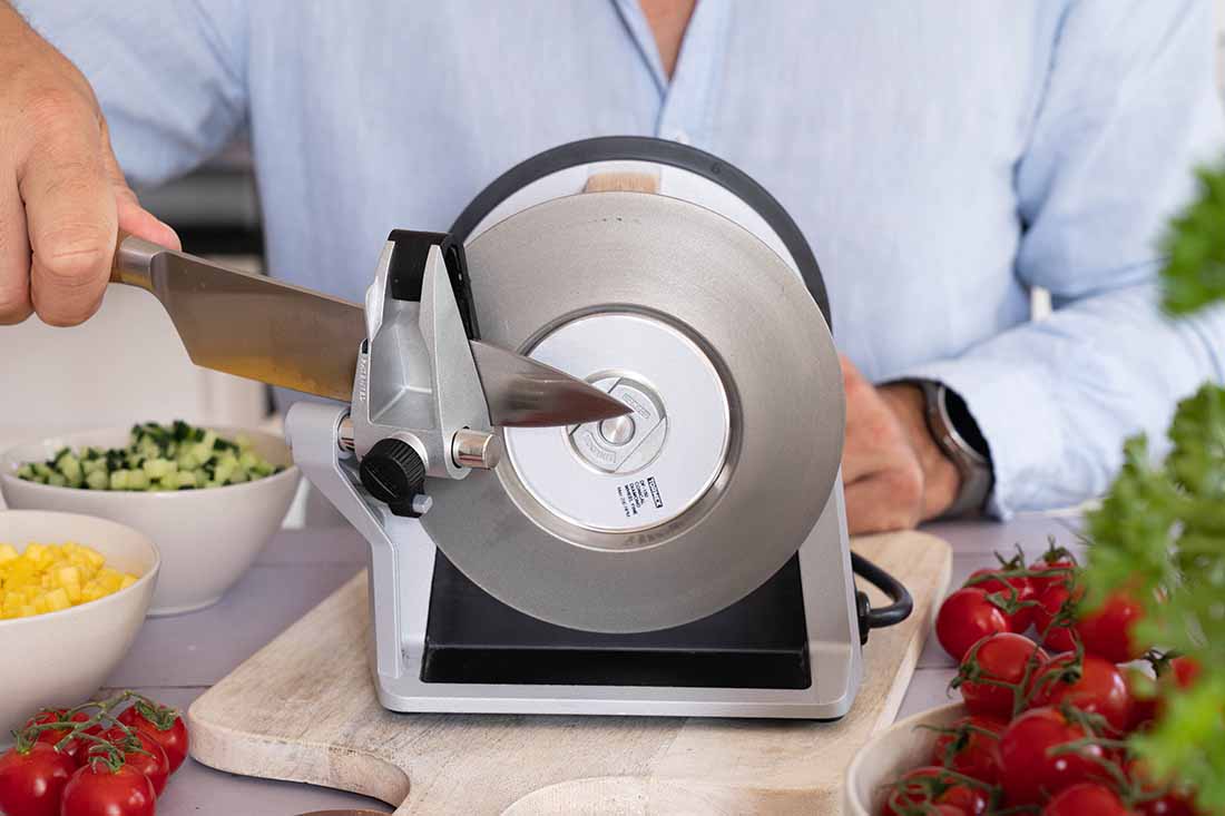

So, to cut things short, here’s a step-by-step guide on how to repeat the existing edge angle when sharpening your kitchen knife on a Tormek T-1 Kitchen Knife Sharpener (video instruction below):
  1. Color the bevel with your EM-15 Edge Marker.
  2. Insert your knife into the plastic clip of the angle guide and adjust the angle so that the whole bevel touches the grinding wheel (approximately). 
  3. With the machine turned off, rotate the grinding wheel by hand. Check where the coloring has been removed.
  4. Adjust the angle and repeat until the coloring is removed on the entire width of the bevel. Now the angle is right and it's time to start sharpening!
If you want to know the exact number for future reference, just check the angle indicator on the angle guide. It won’t get much simpler. Happy sharpening!
